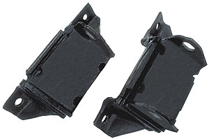

Sunman, is the motor mount I should use with my brackets?
Trans Adapt seems to be making them.
where did you find those mounts? what website address?

update to question regarding trans-dapt mounts, I found part number 4982 available on amazon, jegs, summit. $53 us for a pair.
Sunman, you think these would work with the engine fitment brackets that were provided by Classic Roadster, the same offset ones that are pictured above in earlier threads?

I searched the net for images of the Mustang II V8 mounts. I also looked at my assembly manual. This is what the mounts should look like for the CRI motor mount (except for the one broken mount):
click to enlarge
I have searched the web and cannot find new ones at all. I am now looking at a custom frame mount I can make to use the late Fox Body Mustang mounts.
