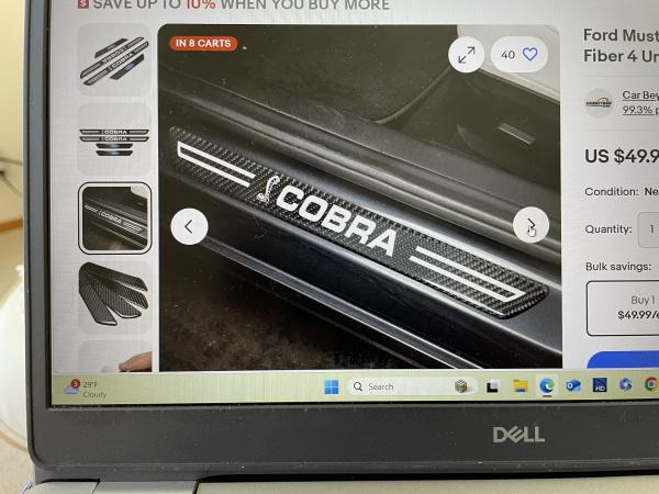

I did not like the door sill with just the bare paint as I can see it getting scuffed quickly. So I ordered these carbon fiber sill plates yesterday. Will see if I still like them when they come.
