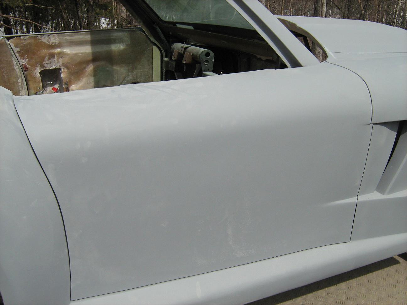

A little slow in posting this weekends update. Traffic coming back from DVs place Sunday night was a nightmare.
Here's some new pics from DVs shop and I must say, a lot of really good progress has been made.
Up on all 4s (a little dark)
A better shot from the side
Down on the ground (nice stance)
A shot of the dash
The master at work (yes that's the one and only DV)
I caught DV sleeping on the job
A shot from the front
DVs famous remote set-up
And one of the jolly ol' fat guy himself (no not santa, me sitting in our baby)
Great work DV!!! We're getting there.....
