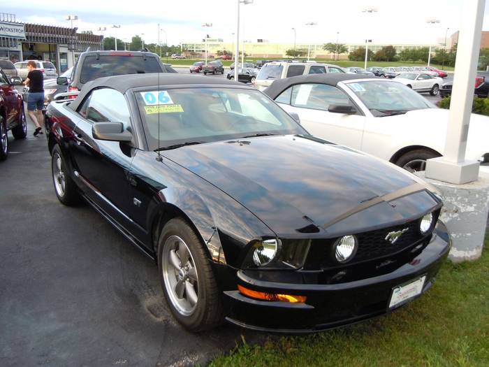

Oh... and someone was questioning my ability to turn a wrench somewhere...
I picked this up about a month ago.
Stock GT on the lot
Just picked it up from the dealer
Since those two pictures. I've added a Magnaflow cat back exhaust system, a Steeda cold air kit with a custom tune, a TCI shifter and a Roush stage 3 suspension kit. And in the words of Gomer Pyle.. SURPRISE, SURPRISE, SURPRISE... I put it all in myself. The only things I haven't done is adding the chin spoiler and blacking out all the chrome and lights. (I'm not good at body work or paint)
Oh. I didn't put the new Foose wheels and Nitto rubber on either

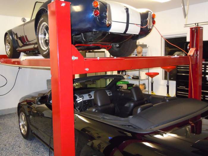

And I do have a Ok garage...

Hay capteddie,
Are you sure that you want to park that Mustang there if the gas tank on the Cobra leaks?
Just a thought.
In that bottom picture, Does the top not do all the way down flush. Looks funny, almost like a rip. Probably not. Nice car though.
Terry
"I may be paranoid, but that doesn't mean they are not watching me"

Originally Posted by tcrist View Post
Hay capteddie,
Just a thought.
Hey Terry!
Top is all the way down. I just don't have the cover on it to dress it up. Its kind of a pain in the ass to put on all the time.
The gas tank on the cobra was drained by then and I also have a tarp that gets stretched across under the cobra and a CCC car cover that goes on the Mustang. Really was just seeing how it would fit.

At least that cover should be easier to put on and store in the car than the car cover. The car cover takes up all of the trunk unless you try to bag it all of the time, and that is a b!tch to do.
I'd still say careful from the gas tank anyway. Mine does not leak but I get a fuel smell (but no drips) if I jack up just the back. And that is with a 1/2 full tank.
I guess that means there is a leak somewhere, I just have not found it.
Should find it before I start seeing smoke.

Cpt.,
That's the new place? Wow!
Terry, if you look close you can see the outlet of the tank, (Totally different than the stock CR outlet) on the very bottom. Why that leaks is beyond me.
Also because of your ODOR does NOT mean your tank is leaking! The "C.R." vent for the car is pretty antiquated, want to fix it for good, look through my gallery and find the FORD roll over valve* we put in the tank, then pick up a (cheap these days) GM Monte Carlo, Old Camaro, etc., "GAS CANISTER", install it up behind the rear wheel well, run the input line to the roll over valve, the other nipple on the canister goes to "AIR" (also works as a vent!) and your fuel odor should all but disappear!
(Thought I would save you all of the trouble trying to find it.)
*Less than $20.00 from Ford, but you have to remove the tank to install.
Cpt., I'll bet that Stang could tow the Cobra!
