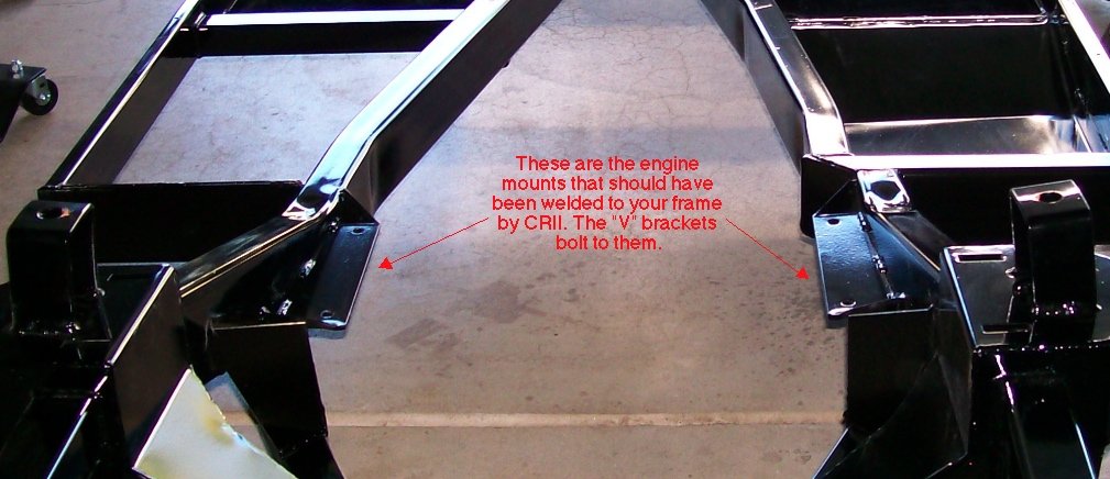

Chris, right below the red "V" (which is laying on its side.) is sitting on the welded in engine mount that is welded on at the factory. The complete engine mount is from Jegs.
I think in a post up a few (dozen?) threads cpt eddie has posted pictures of these v's. Do you not have the welded brackets on the frame that the V's bolt to?
DV
PS. The V's come seperate in the kit and are raw steel.

I zoomed in the best I could without losing picture quality.
Here's the raw mount ( the "V" mount or bracket) before powder coating.

Here's the mounts that should already be welded to your frame.

DV and Capteddie,
Great pictures of your mounts, but my frame is not like those pictured. I sent DV a private message with a link to pictures of my set up.

KCMCHRIS,
I've been building these since prior to 97' I have neveer seen one without the frame mounts that eddie is showing, granted his motor mounts are the new ones but the actual frame member should be welded in. Now assuming they are not (?) then you are starting from absolutely scratch and assuming you have the mounts you are planning to use at the right height, right angles and the right locations for left and right is going to be a big maybe! I have done what you are doing a hundred times with street rods as they don't come with any type mount location. If you want get a paper, pencil, tape measure and call me I will take all the time you need to locate the mounts you are using correctly.

Attached are the pictures of the mounts and insulators which are on my 97 CR. If anyone has pictures of a similiar set up, pictures of the motor mounts and frame mounts would be helpful. Ultimately I need to figure where to put the engine in the frame. I havea302 engine and measurements from the front of the steering cross member to the timing chain cover or block will help

Thanks to all for the information. I solved the problem with DV's assistance. I do not have a Classic Roadster, I have a Classic Cobra Car.
