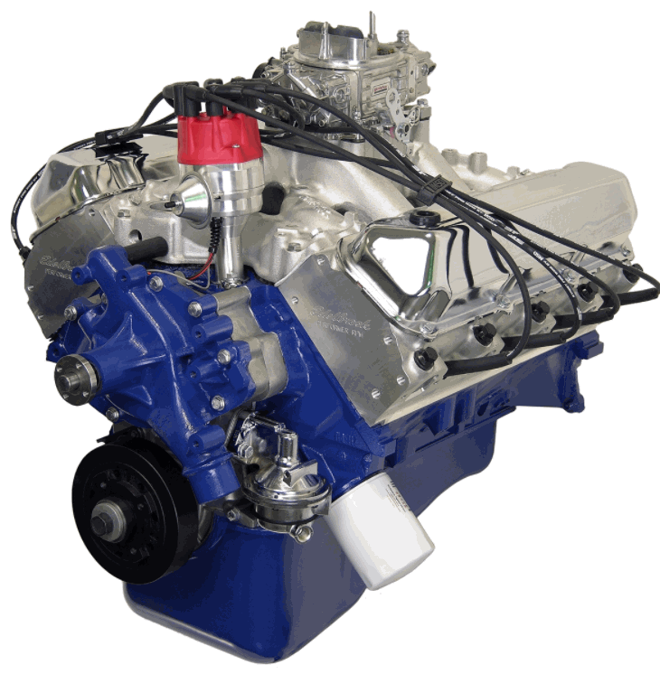

I run a relatively tame 502 (a 460 block with a 4.39" bore and a 4.15" crankshaft, 225/235 degree hydraulic camshaft, 9.5:1 compression). It makes 515 hp at 5200 rpm and 585 ft-lbs at 4200 rpm. During the summer months, it runs pretty hot in heavy traffic, about 220F. I really like the wide power band and the sound of the engine, but granted, it's not a traditional setup by any means (e.g., not an FE engine). It's not true to the Cobra heritage.

OTOH, if shelby was still building Cobras in the '70s and '80s he'd likely have been using 385 Series engines - unless he stopped using Ford engines.
