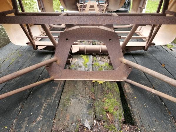

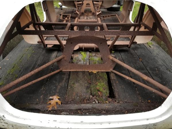

Slordr2000 11-20-2023 08:20 AM
1 Attachment(s)
Trying to post pics hopefully I can figure out resizing pics

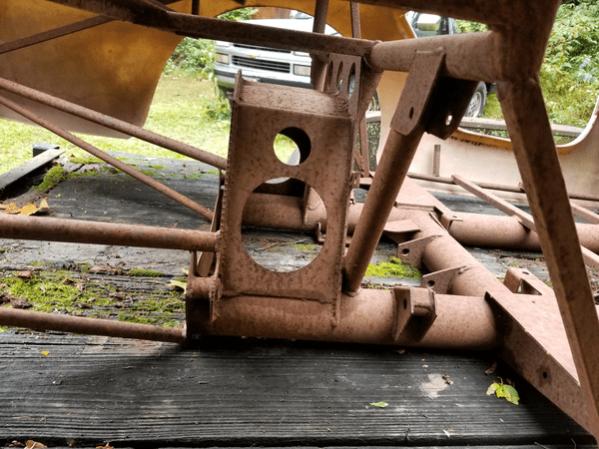

Slordr2000 11-20-2023 08:26 AM
1 Attachment(s)
rear frame

1985 CCX 11-20-2023 10:07 AM
My guess is an old HTM 289 frame, 20 years ago think it was somewhat limited to maybe KMS otherwise.
Might be a Sagebrush Roadster (post HTM), either way its better than most.
Take pics of front flare as HT was pretty easy to see.
Assume its a cloth body, not chopper gun. If cloth really thinking HTM or Sagebrush.
Tjd 11-20-2023 12:00 PM
It does look like a hi-tech . I have made parts for people that have hi-tech chassis that were not complete and I was able to help them out. Let me know if I can help.

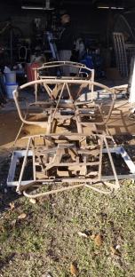

Slordr2000 11-20-2023 02:38 PM
1 Attachment(s)
mold buck and car and frame

1985 CCX 11-20-2023 03:37 PM
See my build thread in scratch built
HTM frame = “289 Progress” with lots views
Looks to me a HiTech FIA

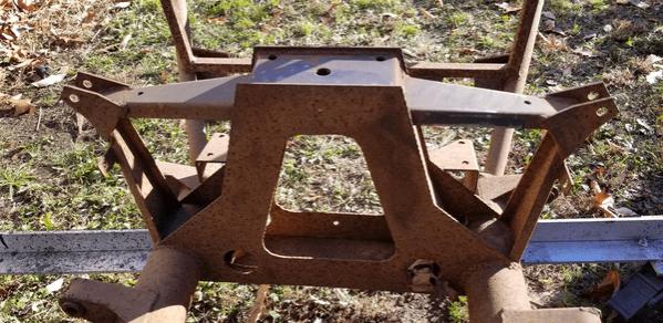

Slordr2000 11-24-2023 05:35 PM
http://www.clubcobra.com/forums/pict...ictureid=21125 http://www.clubcobra.com/forums/pict...ictureid=21127 http://www.clubcobra.com/forums/pict...ictureid=21126

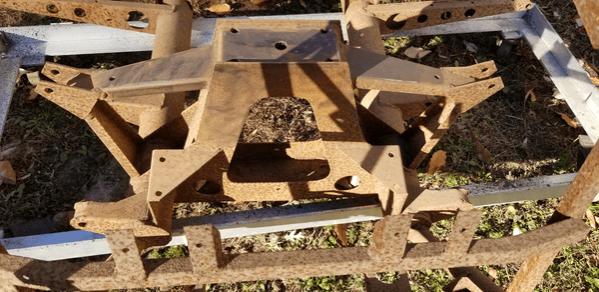

Slordr2000 11-24-2023 05:38 PM
Here are other frame picshttp://www.clubcobra.com/forums/pict...ictureid=21132 http://www.clubcobra.com/forums/pict...ictureid=21131 http://www.clubcobra.com/forums/pict...ictureid=21130 http://www.clubcobra.com/forums/pict...ictureid=21129
Slordr2000 11-24-2023 05:40 PM
The thing that I find interesting is the plates for the front and rear suspension cradles have serrated edges, like it was cut using a punch press
