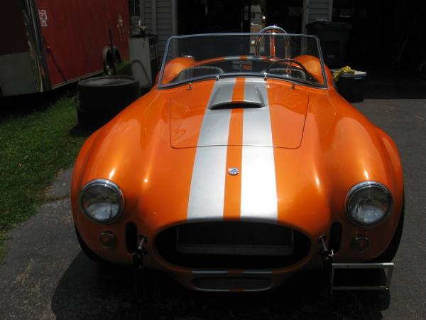

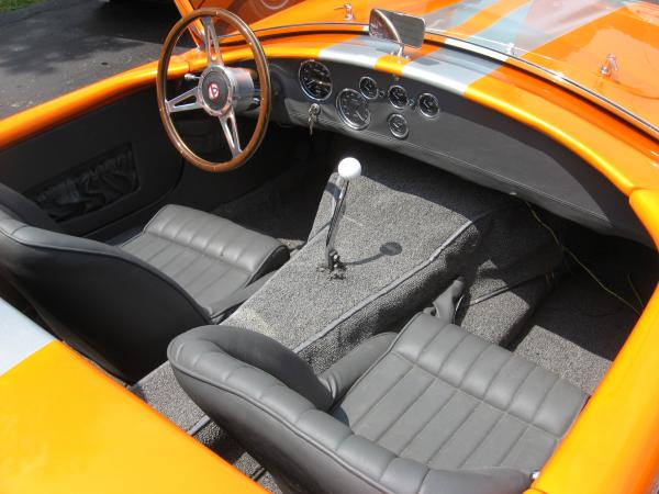

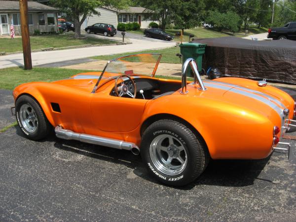

After 14 months of building i finally got to drive it, although it is not totally done it is road ready. I live on a private street and figured i would go easy and make sure everything was right, well the drag racer in me made down 3 houses and i brought the rpms up and dumped the clutch, 547 hp smoked the tires really easy! no kids were on street then took it for about a 5 mile drive. Got a couple of bugs to work out but what a ride these cars are!

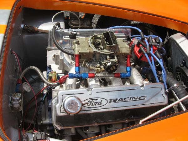

I see you have a 351c. 547 hp! Wow! That's way more than my wimpy engine! How is it built? As previously said, respect these cars, they bite!

engine is 408ci 4.030 bore, 4.00 stroke, rev-tec pistons with about 10.50 comp. heads were done by Tim Meyers in Fairmont Minn. He specializes in clevelands and built the trick flow heads. He is a dealer for the Australian
heads but said he could get same hp for less money and i am very happy with the results! Intake is Edelbrock RPM Air gap with a holley 750 Steve Morley in Fenton Mo. assembled the engine and did the dyno. 547hp at 6000 rpm and 539 trq at 4800 rpm. Very pleased with both engine builders. Steve also assembled a 505ci Jon Kasse engine that dynoed at 830 plus hp in my 73 mustang. Steve is a very good engine builder here in Mo. and i would recommend him to anyone!
