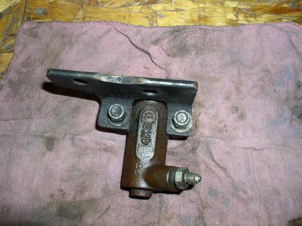

Back together again and working. Part number was Wagner SC124369, purchased from Napa Auto parts. Picture to follow for anyone else who encounters this problem.

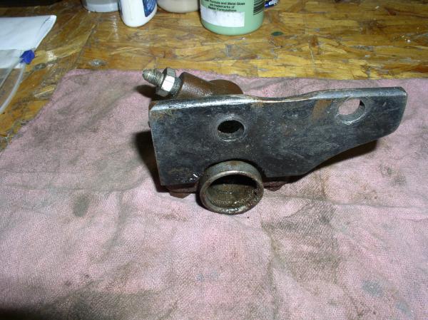

Old 06-16-2010, 07:10 PM
streetrod1927's Avatar
Location: Farmingdale, NY
Cobra Make, Engine: Contemporary Classic Motor Car; 427 S/O
Posts: 263
Mick: Some pics of the old slave cylinder and mounting plate.
