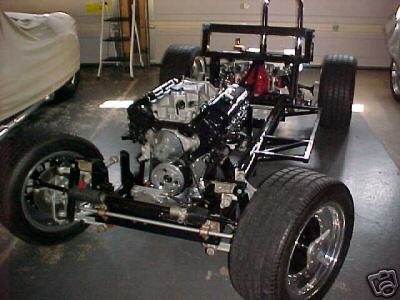

Nick, Thanks. I have a photo of the back frame and rear wheel area on my iphoto I'll send you. (dont know why they wont upload, probably too big) There seems to be a lot of room between the rear frame upright and hub for the pipes to fit. It would be a nice mod to throw in with the floor mounted pedals. Any idea what the size of the pipe in the pic is?

On thing I've always wondered was if there were any problems with flow in this design? I'm sure we all know its not going to run as well as sidepipes but ya gotta wonder. Still all in all I think Im leaning to the street version instead of the SC. It can always be changed. Ive heard that having a cross over helps a lot. Not much room for that though.
