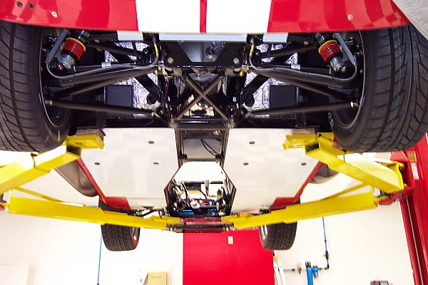

I have Superformance Coupe 140 and a two post lift. I use the aft points of the aluminum plate that holds the engine bay fans for the forward lift points. The aft lift points are where the underneath sheet stops which has a frame member that extends to the edges of the frame. Here are a couple of photos. I am somewhat cheating since I haven't installed the headers yet.

Now THAT'S what I'm talking about! Thanks for the pix. That is really helpful. By the way the car is looking good! Clean enough to be in an operating room.
