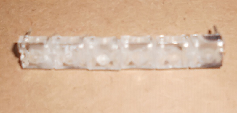

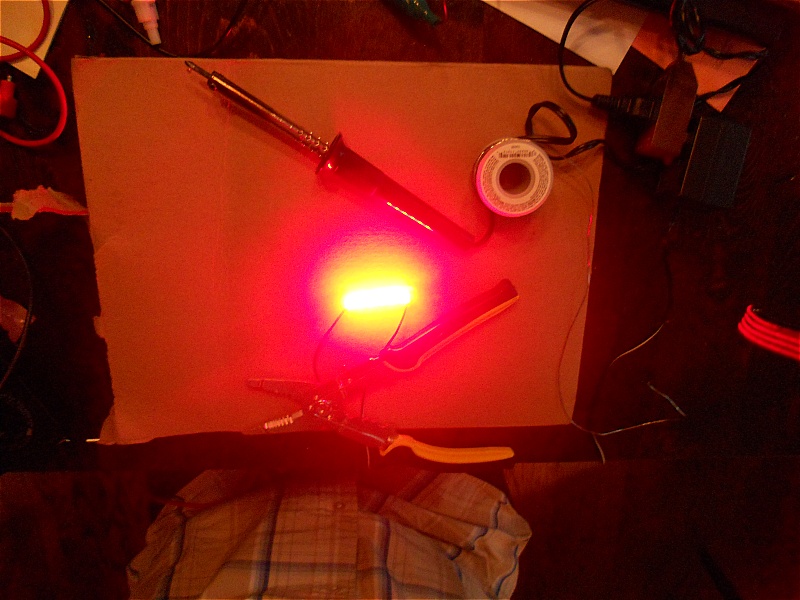

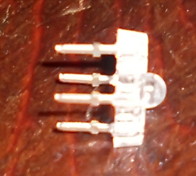

OK, here's a picture of what the LEDs look like. The little round bulb is only 3mm in diameter and has a height of only 1mm. It will barely stick past the chrome hole in the license plate light.
Here are six of them superglued together. The back has the little prongs soldered together.

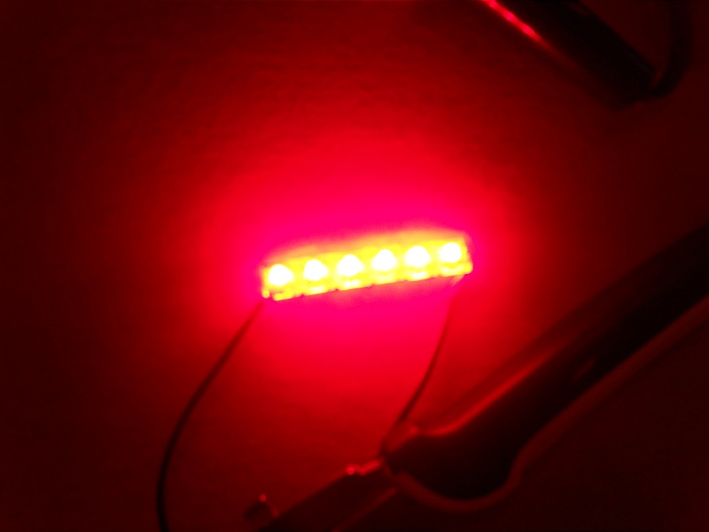

And here are some pics. I think it's definitely bright enough. Tomorrow I'll take a crack at drilling the six 3mm holes in the license plate light and mounting it in there. If it looks good, I'll keep going. There's a little plastic liner inside the light that will require some fabbing, and I'll need to add a little resistor as well. I'll only tackle that if the six little LEDs look pretty much invisible in the light itself. Here are some shots of them lit. It's pretty tough to take a picture of a lit LED, so no complaining.

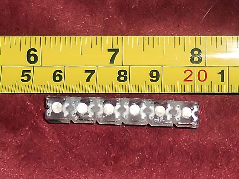

I don't think so, but I'll try and figure that out as well. The trunk light is almost exactly 24" off the ground. OK, here's a decent shot of the six LEDs that are glued together. This will give you a feel for the size. Of course, if I screw up the drilling of the six 3mm holes, or if it looks like crap, then I'll just trash the project. These LEDs are only about twenty five cents each.

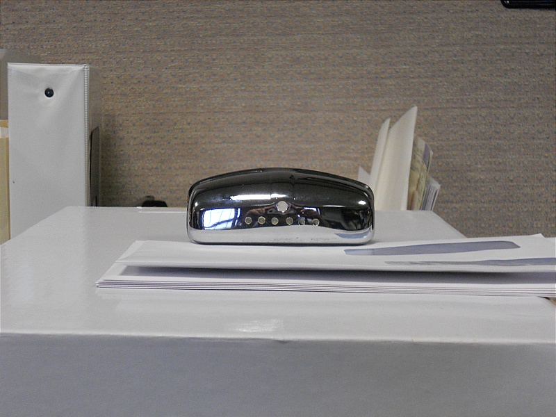

Here's a pic with them installed in the light fixture. If you didn't know those six holes weren't supposed to be there, you wouldn't notice them. All of the "innards" of the light are now installed as well. All that was needed was to use the Dremel cutting wheel to cut a piece out of the inner plastic lining.
