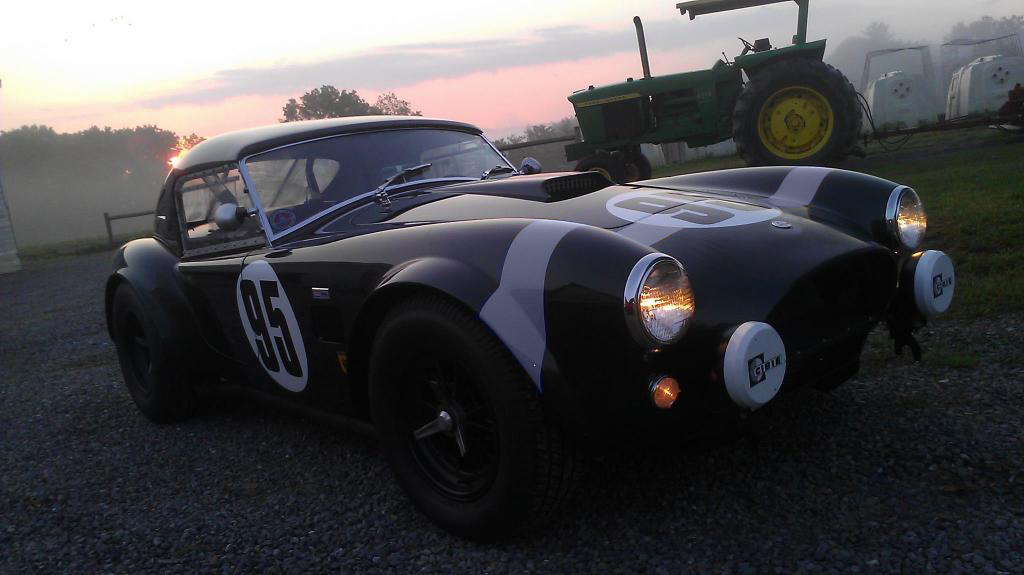

Really appreciate all the discussion and banter on the color/stripe...really cool to see the alternative photochops. Just for giggles, it's been a while since I've taken any photos of the car with the top removed, and it's supposed to be used in a wedding this coming weekend. The groom is too "large" to fit in the car with the top on, so off it came. I say "supposed to be used" b/c over this past weekend, I also burnt up the stub axle I replaced over the Winter...turns out stub axle bearings don't get "splash" from the main diff casing and you are supposed to "pre-oil" the bearings in the housing before installing the assembly to the differential...well, guess who didn't realize that, fried the bearings, and had to get towed home yesterday - that would be me... So now I'm frantically attempting to reach Coventry West to get a replacement fast-tracked to me so I can replace it before the weekend (their phones were down today???). I'll have more on that tomorrow with a few pics of the fried stub axle housing. For now, here are the topless glam-shots taken earlier in the weekend:

Originally Posted by Fullchat289 View Post
- Allen.
Allen - what's that thing on the roll bar strut? Looks like a valve?
Bad luck about the stub axle.
Glen

Allen,
Very nice photos ... beautiful car !!!
Photo tip ... next time turn off the date stamp ...
Keep up the good work !
- Tim

Glen,
That 'valve' on the roll bar down tube, looks like a camera mount to me.
Nice work Allen!

After seeing these pics, which are awesome, I'd change to a white stripe that matches the meatballs.

Originally Posted by tkb289 View Post
Glen,
Nice work Allen!
Ha ha, thanks Tim! Sometimes I maybe overthink a little!
Glen

Doug: Yes, I modified the triumph steering column to add a Sweet Mfg quick release and a Sparco wheel for auto-x.
Glen: Tim's right...that contraption is a homemade camara mount made out of a piece of PVC pipe/cap, some clamps, and a bit of metal.
