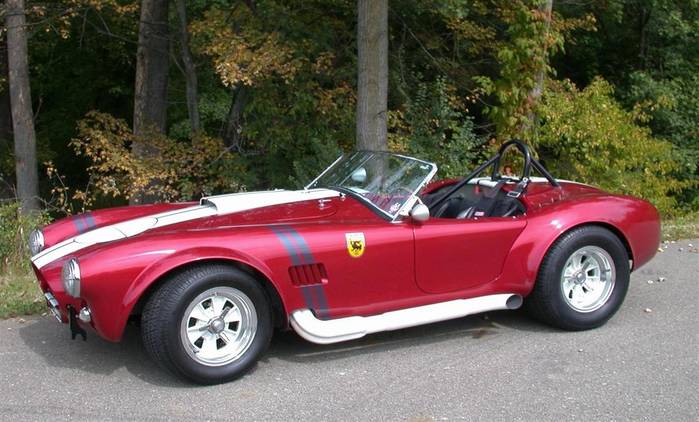

Original FIA wheels 6 1/2 X 15 and 8 1/2 X 15 with Avon ZZR tires 215 front and 245 rears:

Several of us, myself included, are running the Firestone Firehawk Indy 500 which is available in the sizes recommended by ERA. Mounted on the 6 pin knockoff. Speed rating is S, which is 112 mph according to the Tire Rack website. Good ride characteristics, but have not pushed it on the track. Everything I read says to purchase Avon if you are serious about track tires with decent street wear.
