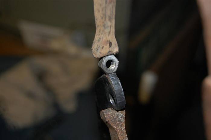

I find out that someone has engineered a pedal adjusting lock washer on the back...

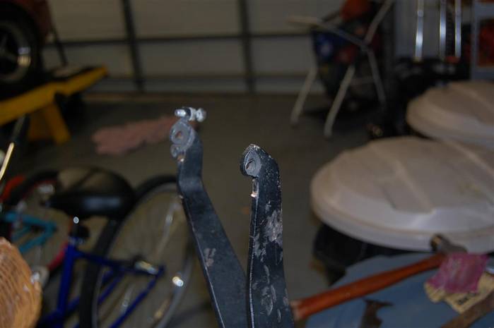

Here's the clutch pedal....
So I proceed to manually adjust the pedal (took a BIG hammer)..
Here's the pedals together (see the adjusting nut and the spring retainer missing)..

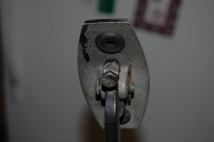

And then I got ready to weld the pedal adjustment nut onto the pedal...
