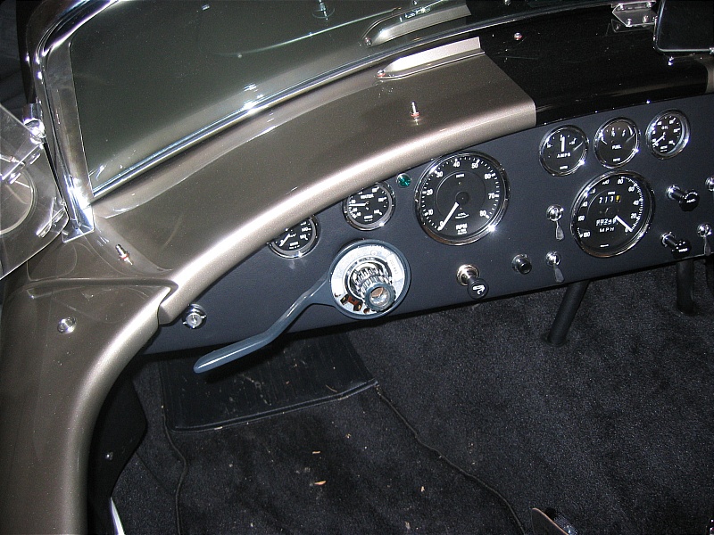

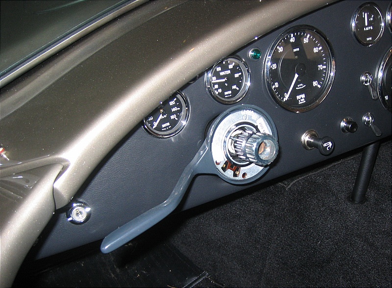

I have it -- very cool it is -- totally invisible. It adds no additional distance from that of the non quick release hubbed wheel, nor does it add "slop" to the steering. It allows you to work behind the dash 1000% easier. It allows you to orient the wheel to your liking so that you can see the gauges that you want to see. It is a theft deterrent, as well.

Thanks. Photos are very helpful!
