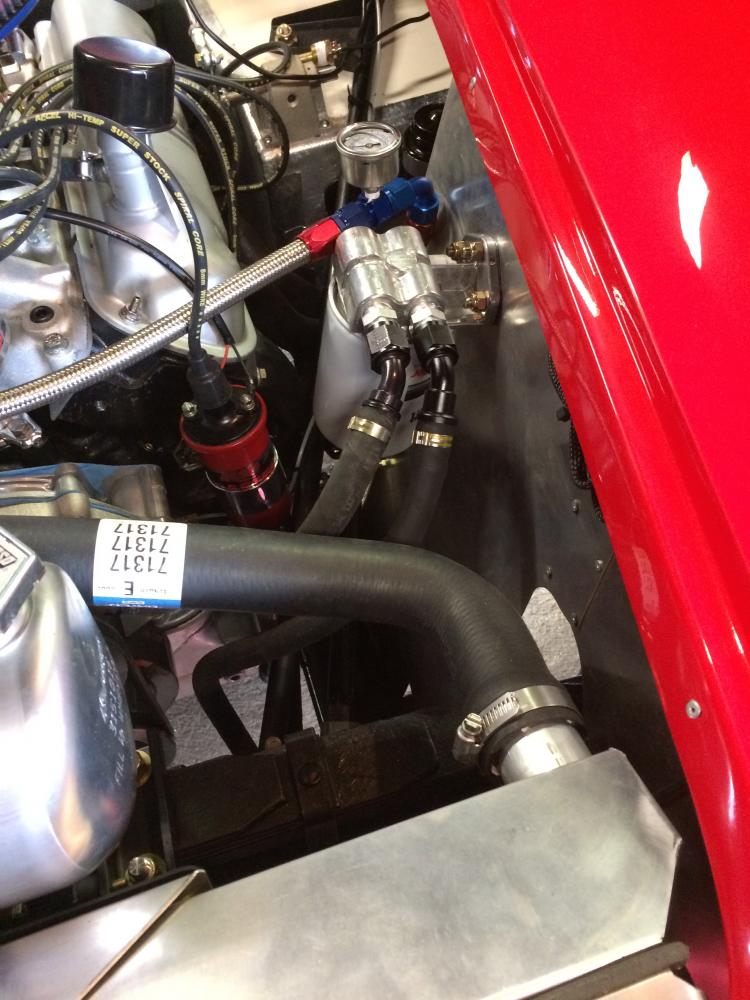

Here are a couple of pics of my ERA 289's oil filter mount. Let me know if you need any other pics or info.
Best Regards,
Byron
Best Regards,
Byron
Thanks Byron! Exactly what I was looking for!

Old 01-02-2018, 12:13 PM
glenview289's Avatar
Join Date: Jan 2004
Posts: 69
Default custom mount in a Unique
Filter under overflow on a Unique.
