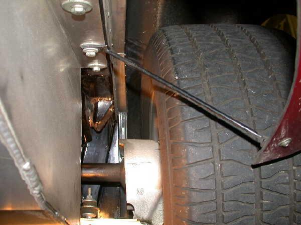

I have BFG Euro T/A's, in size 305/50X15, on 10" PSE FIA wheels on my ERA FIA. No fit problems anywhere.
The Euro T/A's are hard to find, I believe the regular T/A's in size 295/50X15 are easier to find. Either one fits fine.

Thank you, So I am assuming that 10" is a pretty tight fit? Looks like your tires are about as far out as one would want to go asthetically. Is you inner clearance pretty tight also?

I've got the 9.5" in the back with 295/50/15's with no clearance problems. That is the size ERA recommends for street use i'm pretty sure. That size tire is actually rather cheap to buy. I think the dunlop gt qualifiers are about $75 a piece from Tirerack.com

Actually, I have about 2.0 inches of clearance on the inside, on both sides of the car. The outside edge, as stated, is pretty much to the edge, and probably would not look right if it protruded out of the fender opening.
