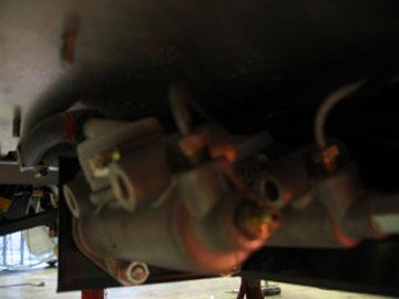

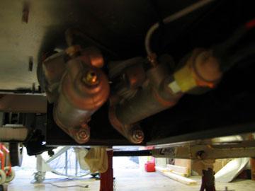

You're a genious! Tach-fixed, Wipers-fixed, speedo-will be fixed. One area where I think there is a discrepancy is the brake switch situation. It appears as though we only have one brake light switch on the inner (rear) master. On this switch, it is closed when the brake is not applied, and open when the brake is applied. Even if it were a redundant switch, it shouldn't operate like this should it? I have attatched pics so you can see what we have.

We may have "trimmed" the second brake switch plug off your harness. Don't worry about it. Just make sure that the pink and green wires on the switch are on opposite terminals. You can cut the violet wire right out of the circuit.
