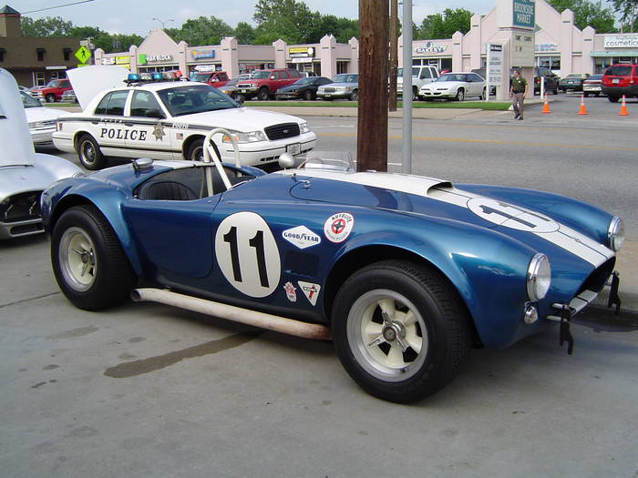

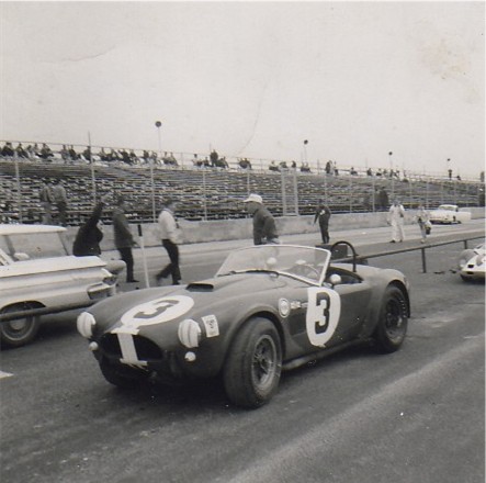

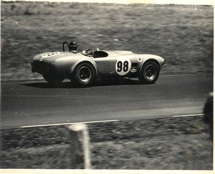

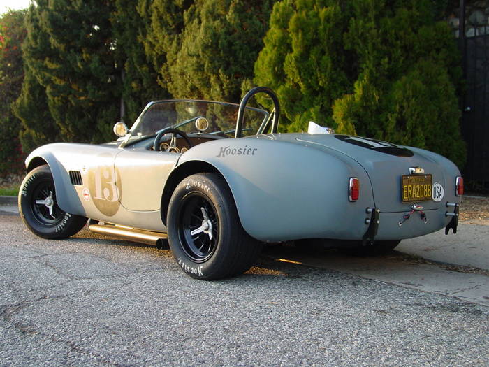

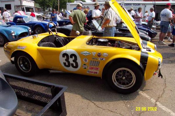

As Bob has mentioned to me previously, the fia cars had that high stance. I want taller tires in the rear next time around to fill more of that gap but my fronts seem to fit pretty well(to my eye anyway ) Tire sizes seem to make a big difference in appearance before & after ajustments. Here are some vintage & modern examples

TP-
Great pic of your car- it looks very nice!

Thanks, Getting the top fitted monday. Hoping to get it out for some "good" pics at somepoint after that.

TP,
Thank you for the pictures and the advice regarding tire size.
BTW - very mean looking car! I have been fortunate enough to have ridden in one of the original FIA's, and yours really captures that early look nicely.
