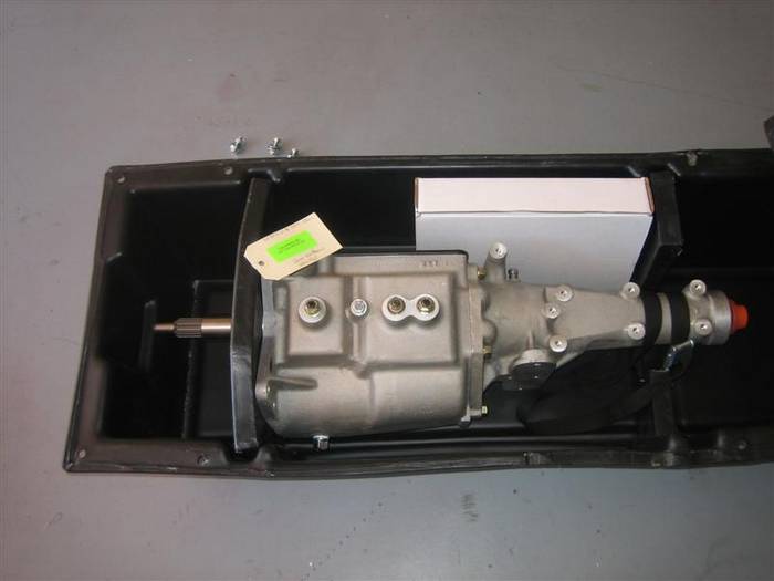

This is sitting in my hall closet in a shipping container I want to sell it for $1200 + shipping, but I can't get the CC Forsale section to let me edit the ad Small spline input (10 tooth), and wide ratio, 28 spline output, free yoke, free shipping container
http://www.clubcobra.com/classifieds...ct=932&cat=500
here is a photo:
Sam

SSSammy,
It just so happens that I'll be in McKinney this weekend for my daughter's soccer tourney. This might be fortuitous.
Just for kicks, what size yoke do you have?
If I go with option #2 I'll swing by and pick it up if that works with you.
