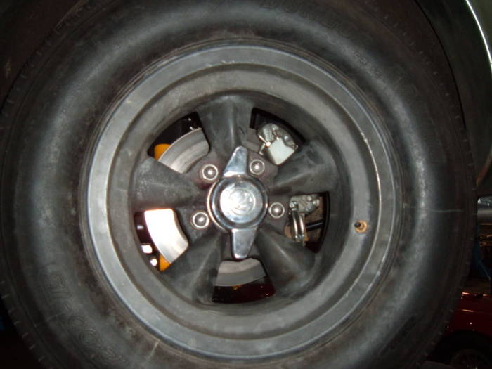

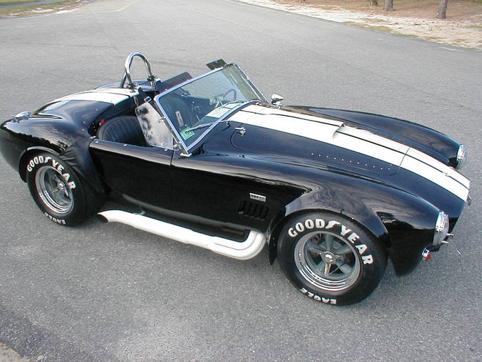

Old 11-27-2008, 07:34 AM
1985 CCX's Avatar
Location: Manchester, NH
Posts: 19,111
Better shot of CSX4252! A top notch CSX cont car!

Old 11-28-2008, 08:00 PM
Join Date: Mar 2007
Posts: 10
I have several pictures listed in club cobra of my cobra with torque thust d rims and spinners . i think they look great They are listed under (lacoste)
Check out ( car_show_001.
Have a great day.
Charles E Lacoste
charles e lacoste
Old 11-27-2008, 11:00 AM
tkb289's Avatar
Join Date: Dec 2007
Posts: 2,129
Jeff,
Great photos!
- Tim
Old 11-27-2008, 08:59 PM
Join Date: Nov 2003
Location: West Barnstable, MA
Cobra Make, Engine: Shelby CSX4252,aluminum body, 427 side-oiler, Webers
Posts: 138
Thanks, Jeff, for using photos of CSX4252 for an example of TTD's on a Cobra. I get many, many compliments on the wheels and I'm very pleased with the aesthetics that they give my car. Billy Andrews at HRE was able to get the machine work done which allowed me to mount the TTD's on the pin-drive hubs and use the knock-offs. I think pin-drive wheels look great but as a kid I remember seeing several competition Cobras running the Torq-Thrust wheels and always thought they were much more racy looking.
