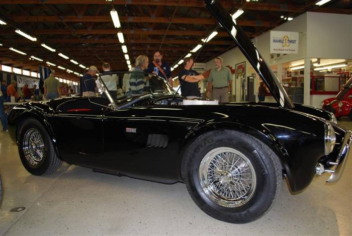

New Slabside offering?
Jeff ... Very tempting ... now especially since it's a reality!
When I started this quest long ago ... I really wanted a 'slab side'. Then I started looking at the FIA body and fell in love with that. Some of the same look as the early car, but with a bit more bulk, so to speak. What I have in mind is a mix of both ... a racy street car / street look race car ... different to be sure.
That being said, I am thrilled to have the choice, the new car is stunning.
