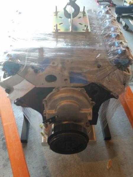

This one is starting with a long block built by Jean Batteaux. OEM Ford 427 block bored to 4.25, diamond pistons, scat crank, scat h beam rods, NOS sidewinder intake, NOS dual point, and Edelbrock heads.

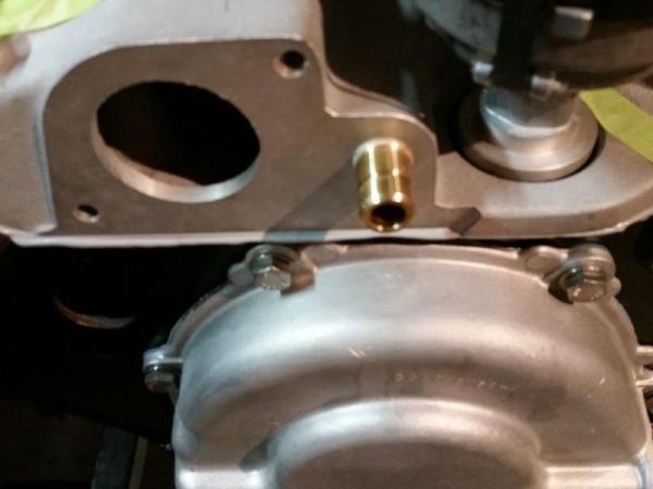

New years day project was to install the water pump. First had to thread NOS sidewinder intake for water bypass nipple.
http://www.clubcobra.com/forums/pict...ictureid=13269
Done:
http://www.clubcobra.com/forums/pict...ictureid=13270

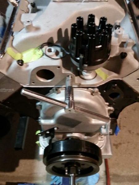

Pump installed:
http://www.clubcobra.com/forums/pict...ictureid=13271

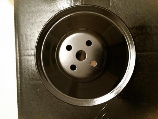

Prep water pump pulley for paint:
http://www.clubcobra.com/forums/pict...ictureid=13264
Waiting for paint to dry:
http://www.clubcobra.com/forums/pict...ictureid=13265

Minor progress. Pulley attached and key learning was edelbrock pump uses 5/16 fine thread bolts.
