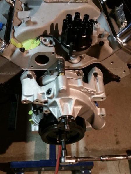

Posts: 146
Minor progress. Pulley attached and key learning was edelbrock pump uses 5/16 fine thread bolts.
