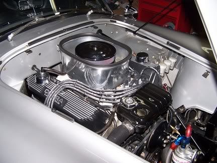

Here's a shot of mine, before cleaning up the engine bay.[IMG]  [/IMG]

Back on topic....yes Burgs, I did use that setup in my engine build because I wanted to detail the way the "loom" laid out. It is a fairly straight forward job with minimal hassles.

The universal kit is really easy to do, just takes time. I like the clean look.
Here's a photo of mine.

Just as a follow up, they worked out great! The stock looms that clip onto the valve covers need to be opened up a bit, but worked out fine.
