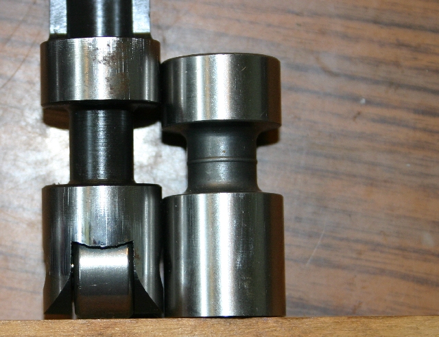

I would love to show you guys a pic of my failed cam roller, but cant figure out how to embed the pic...
We'd like to see it. After my buddy Ron's roller lifter failed in his FE for a 2nd time (a few years back) he gave up and went back to old school. However, we all know the cam manufacturers have been working (or fixed) this challenge over the last few years and hopefully it's clear these days which ones fail (and why) and which ones are fixed. What brand of cam and rollers do you have and how long ago did you purchase them?

What failed in yours? My understanding is that usually a needle in the roller gets punded flat and causes failure.

Thats what happened to mine, the needle bearings went flat, the roller stuck and then the roller got 'flat' and broke off the lifter.
Note there is no 'forced lubrication' to the standard roller needles bearings, it is splash only (requires maintaining a reasonable rpm at ALL times). Newer solid rollers CAN be 'force fed' oil pressure, which address' the problem of needle failure, but bring some CUBIC dollars and the right block.
I also had to change push rods because of the difference in hieght from roller to flat tappet.
