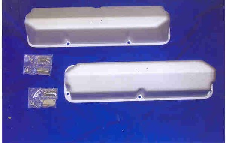

Here are the ones I ordered.
http://www.dscmotorsport.com/asp/Pro...to.asp?ID=1038

I don't know. That little indentation for bolt clearance on the top side with the three bolt holes looks problematic. The finned cast ones didn't have that much indentation.
I like the cleaner look of the ones you're ordering better, but knew the ones I ordered would fit since I had seen them on the engine earlier. Keep us posted when you get them.

Been using the Comp covers for a few years now with no problems.http://www.clubcobra.com/photopost/s...9&ppuser=10990

The cast aluminum 427 valve covers I got had to be ground down an 1/8 in the end sides to accomodate the dove set up ,figured it was typical .What was the erson clearence issues , at the ends also ?

So they will fit, I'll just need to clearance a bit?
Or do I need to specify the Comp version? What's the difference between the two?
Old 03-19-2008, 06:42 PM
Location: Louisville, KY
Posts: 9,417
I think the non-comp ones will need clearanced.
The comp versions will probably fit. They also have a couple holes per valve cover for PCV valves, breathers, oil fill, etc.
