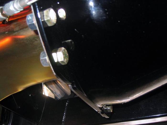

BB, you're not working/playing well with others. ERAs need the trimming at the bottom, and I can't believe it lessens the integrity of the bellhousing in the least. Here's a couple of shots of mine so you can see what I mean:
The only thing you lose is the SFI rating when you cut it.
