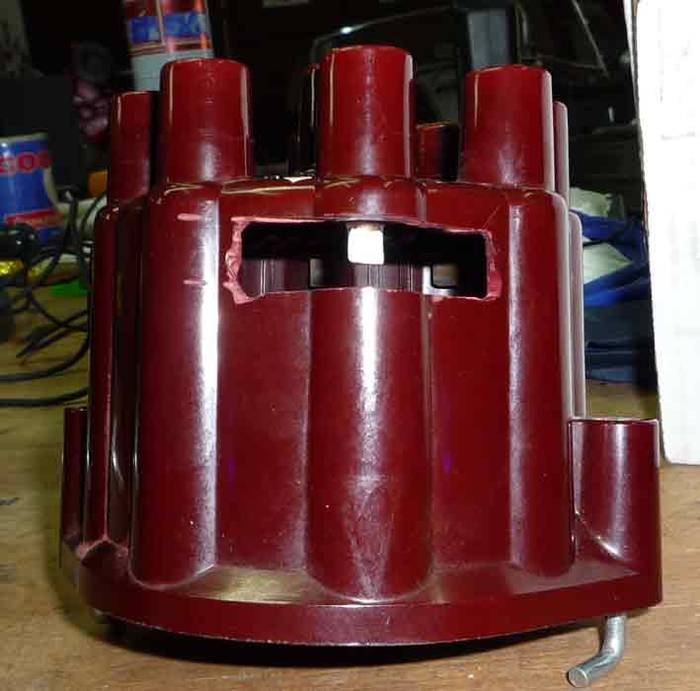

I finally think I found what was wrong. I modified a distributor cap making a big square hole in front of one of the terminal points for cylinder #1 and checked with the timing light
The spark would jump while the rotor point was past the #1 terminal. I did loosen up the screws holding the magnetic pickup and pushed it as far as I could to the most advanced position.
Now the point and terminal match perfectly at idle and at max engine speed.
Apparently MSD does not do a perfect job in phasing the rotor as they claim.
Now the timing is consistent and does not jump around above 3500 rpm.
I also made myself a larger stop bushing (10mm diameter) in order to be able to set 21º initial advance with a max advance of 36º.
The black stop bushing MSD provides did give me with a 21º initial a 42º maximum advance. Some wear of the interior diameter and a not very tight fixing was giving me 3º more advance than the 18º advertised.

If your center button is worn you need a new cap. Use this one now to make the hole in it. Mark the terminal with white paint ant make a vertical white line on the rotor too where the rotor terminal is.
I did bend the rotor center spring upwards to make real pressure on the central button in the cap. Centrifugal force tend to push it away and down.
I got myself the cap with the holes drilled in it to prevent ionization and rust inside the cap.

Wow, that's some hole.
The MSD articles suggests drilling into the top of the cap. Is there any special reason why you went into the side?
Paul
  #29 (permalink)
Old 10-05-2009, 03:13 PM
Eljaro's Avatar
Location: Palma de Mallorca, Spain, ESP
Cobra Make, Engine: Contemporary with 482 KC/SO, TKO600,IRS Jag/AMP, 3.54 Salisbury PL,
Posts: 582
If you drill a hole on top with all the spark plug cables you see nothing.
On the side you can mark the rotator with white paint where the tip is and you see exactly when the spark jumps.
