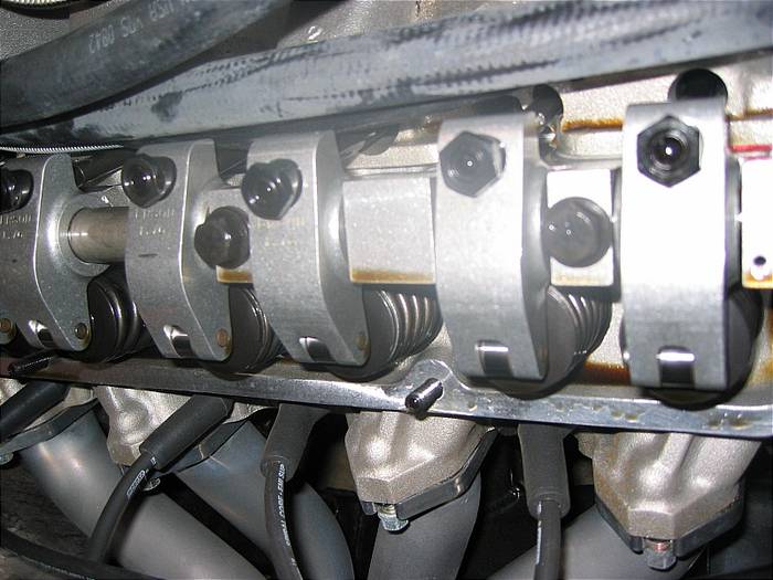

Hi all, I'm just now starting to get my photos loaded so that I can put this thread all the way together so please be patient. However I just came across something that's odd even for my "2 steps up and 1 step back" build and thought you guys would like to laugh with/at me. At this point I just got to bolting the intake down after having it on then off about 15 times checking and clearancing things. Then of course the pushrods and rockers get bolted down and I go to put my cool looking H/M VCs on just to keep dust out and this is what I found:
Notice anything missing?
Seriously, WTF!? I can't believe that I now have to drill and tap for a VC bolt hole at this point. Why hadn't I noticed this before? Duh! WTF is with it not being there anyway?!
More to follow................................
Steve
BTW, anyone have a dipstick and tube they want to get rid of for a reasonable price? How about a WP pully?

First off yes I did not chase all the bolt holes in the head. I did do that with the block but it's a 40 year old piece and the heads are new. I will be drilling the head while it's on the block, I did the other side with a piece of bolt in it and sweated the entire time I was working on it. This one should be much easier; at least the bit won't be bouncing off of bits of peanut butter bolt while also cutting aluminum. My biggest worry is not getting the hole straight.
To answer about the studs, even using threaded rod would not work in this case as the head of the allen bolt sits down in a recess in the VC. And yes, for the price I paid for having something different I expected better quality components. I hope they don't use hardware like this on their GT40s.
Now on to other offending studs. In this pic you'll notice the cool ARP studs and nuts holding the killer KC recip assy.
Guess what happened when I tried to mount the Moroso RR oil pan? Yup, no clearance for the studs on the rear main.
So, back to bolts for the rear main! And the saga continues.
Steve

VC, bolt hole drilled and tapped; thanks Rick. ****-canned the stainless bolts and went with steel. I may have to worry about rust on the bolt heads but I won't be twisting one off with a T-handle. Here are a couple of pics showing how it's coming together;
I couldn't find a definite answer for this, so will someone look at it a tell me whether I have the oil routed correctly or not?
Now on to the headers. Considering how heavy these puppys are and how thick the flange is, they are some wavy, out of shape, heaps. I don't know if I'm going to be able to get #4 to seal w/o some surgery. What do you guys think?
Better view;
Someone really didn't want to be making FE headers that day I think. In this view with a straight edge, you can see that the flange is twisted on 3 axis. Not even close to straight;
That's it for now guys, Steve
