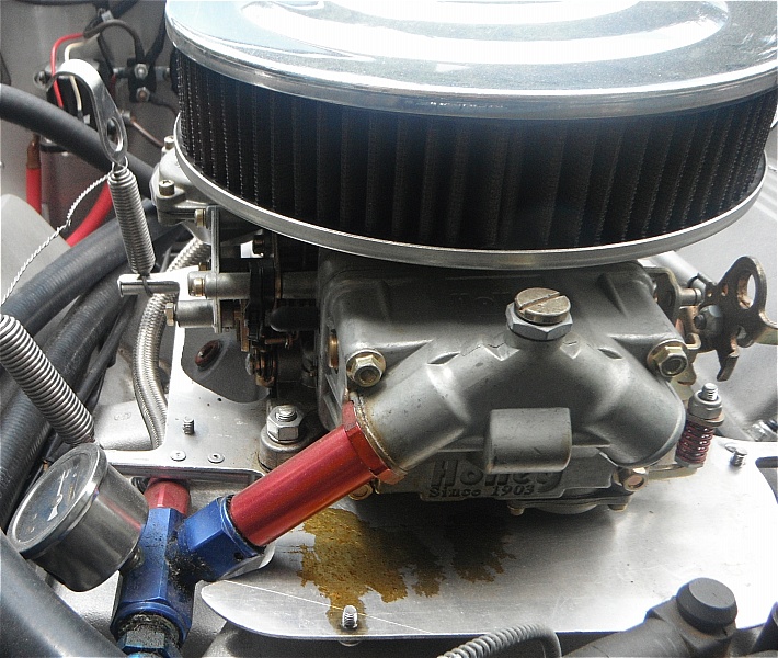

Yes, I have been using it regularly for the last three or so years with apparent success. For several years, my Holley would clog up around the second fill-up after pulling her out of her five month sleep over the winter. I've posted about clogged air bleeds and ethanol on here numerous times and, after the first time at least, you could almost feel it coming -- and it comes quick, and with debilitating results. About three years ago I started using the Lucas additive and I haven't clogged once. Now that could just be a coincidence; I don't know. I did have a nice little fuel leak, from a dripping fitting, last year and what was dramatic was the puddle of "goo" that it left. It was just like the syrup that you put on your waffles. Here's a pic. This is what is gooing up your carb.:

I use the Lucas Safeguard in all my engines. Works great. Tore the carbs down on my Yamaha Rhino & they looked like new. No alcohol effects whatsoever. Usually the needle & seat is eaten up by the alcohol but the Lucas has neutrolized all effects. I'm sold on it.
