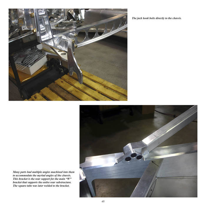

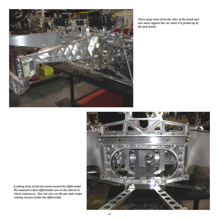

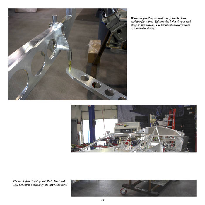

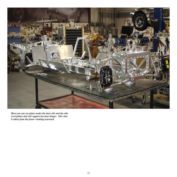

There were a LOT of bolts to tighten! Notice we used button head bolts on the interior so the driver wouldn't catch his feet on the bolt heads.
