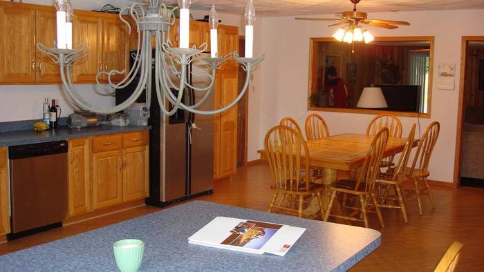

I'm gonna show you some pics if I can find them. I THINK.. or assume, and that could be a bad idea when it comes to shoddy work... but I think a larger wire was run to the 2nd floor where they have kind of a junction box. It then splits like 5 ways which I would assume is hallway, 3 bedrooms, and attic. It would be easy to do a fuse panel on the 2nd floor because there is an attic on the 2nd floor above the family room which was added on in 2000. I planned to finish it and use it as a game room this summer.
These pics are from when we viewed the house before we bought it. Since I'm over here, It's tough to get too deep into it.

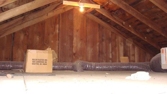

First pic is of the 2nd floor attic junction box
This is the attic (3rd floor) No insulation. Fireplace is no longer functional, it was bricked up.
The 2nd floor attic area has no insulation at all. None in the floor, walls, or ceiling.

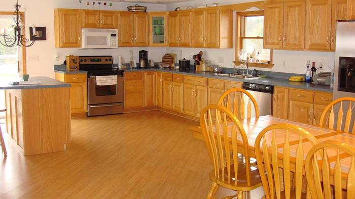

Given the size of this kitchen. i am certain it loses ALOT of heat having no floor insulation. It is 17'x27'

From your pictures, I think you might want to insulate the roofing ( not the attic floor, but the attic ceiling ) and then cover it over.
You put in insulation with the vapor barrier towards the living area and then pick a tongue & grove board to cover the ceiling ( I would use this because it will last and take a beating and is a LOT less messy to put up).
Those look to be 2 x 6 boards, but if the house is as old as it appears ( the porcelain insulators ) than they may be rough saw. Nothing wrong with that, but new materials may take some fitting.

BTW, Like your kitchen.

Yea certainly the way the j-box is done is not the correct way to do it.
If you are going to enclose the attic space then yes insulate the ceiling and not the floor. Depending on what is under the floor I still insulate the floor for sound deadening downstairs, and yes it does help the downstairs maintain temperature. I have done this in my own home and we hardly ever used the A/C or heat in the downstairs because it was insulated so well. Pay me now or pay me later so to speak.

Yea, the kitchen looks great!

Good point 727pilot, there are those cardboard spacers that make a 1 or 2 inch space. I am not sure they would come in 'odd' widths, but it would be worth the try. They are so the roof sheathing is allowed to breath.
Steve, I see nothing wrong with that Electrical box, it would pass here in Michigan, although all of the wires must be tied within 6 inches of the box. Those standoffs above that box wouldn't, but the steel box fit the NEC.

It is not the box that concrens me, it is the number of wires tied together inside of it. Those must be some huge wirenuts.
The main wire does not look large enough in the picture to carry the load of the combined "others" coming out of it.
