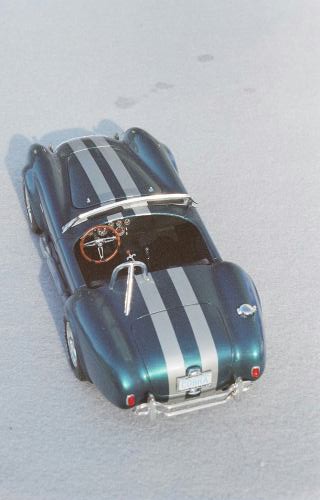

I took the easy(well, not that easy) route. Took the metal diecast, and stripped and painted it to match.

Originally Posted by 02roush View Post
Very cool. Very interested in the end result and following along your build!
That looks good and I assume you painted it to match your full size? I'm working the other way around... building a 1/8th scale one in preparation to build a 1:1 at some point, Lol! Thanks for the pics of yours...
