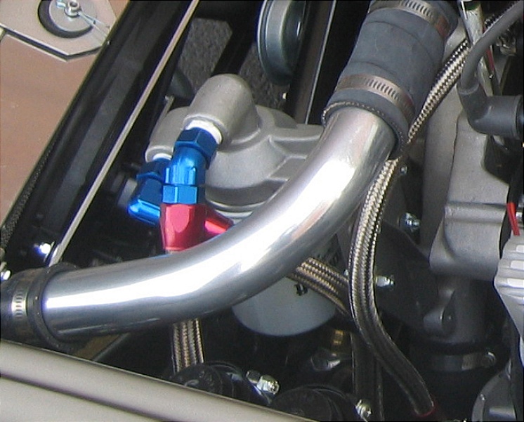

Forget originality, if they bug you, remove the coating -- it's a snap. I had the red/blue fittings on my remote oil filter fitting and, after a while, I changed my liking. Fifteen minutes after taking a Dremel tool steel brush attachment to it and, voilą. It would have taken me longer to have actually changed out the fittings themselves. Here are the before and after shots:

Patrick, I like your quick fix. It is tough to see but did the wire wheel leave the fittings scratched up?

No, it didn't. It's a really easy job and, what's more, you can "trial test" it before you actually do it. Go to your local auto parts store and buy a red or blue anodized fitting end, for about two bucks, then try your Dremel brush out on that one. That's what I did -- and I was surprised at how easy it was and the fact that I had not read about it before on the bazillion car forums that I follow.

Here's an up-close shot I took while I was doing the job.
