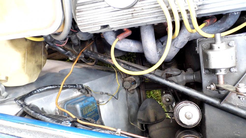

I have the (hopefully) correct Lucas 7H horns for my leafspring 289. I know they weren't always fitted in the same place, but does anyone have a photo of a typical installation before I start drilling holes in the frame for brackets?

Old 04-17-2013, 07:23 AM
1985 CCX's Avatar
Location: Manchester, NH
Posts: 19,111
Rocky's 289
Don's
Old 04-17-2013, 08:45 AM
rsk289's Avatar
Join Date: Nov 2004
Location: Cambridge, England, n/a
Cobra Make, Engine: 289 leafspring, r/p
Posts: 518
Wow! Never expected them there - I was planning on fitting behind the grille, in front of the rad! Those look like 9H horns, with the big hemispherical casing. Still available new from Holden.
