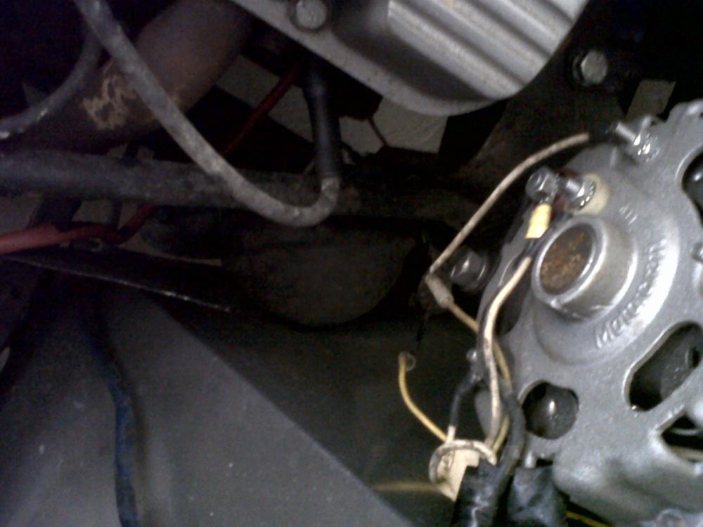

04-17-2013, 08:23 AM
Location: Manchester,
NH
Posts: 19,111
Rocky's 289
Don's

Wow! Never expected them there - I was planning on fitting behind the grille, in front of the rad! Those look like 9H horns, with the big hemispherical casing. Still available new from Holden.
Thanks - food for thought....
