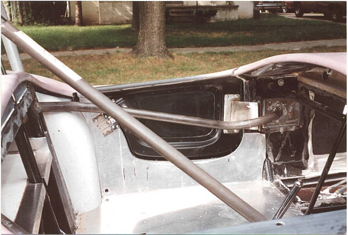

Old 03-06-2012, 12:09 PM
Join Date: Dec 2003
Location: Gurnee, IL
Cobra Make, Engine: Kirkham #259
Posts: 1,396
Thought you'd like to see some photo's of KMP259 doors.....

Old 03-06-2012, 06:10 PM
Join Date: Jan 2012
Location: Missoula, MT
Cobra Make, Engine: Figment of My Imagination, Inc.
Posts: 7
Nice pictures both of you. The more the better. I am new at this, Bill E - you said that tying the front and rear together @ the doors would allow you to take weight out of the end that needs it. I am assuming you are talking about the front? How and where can you lighten things up front by putting framing at the doors? Thank you in advance.
