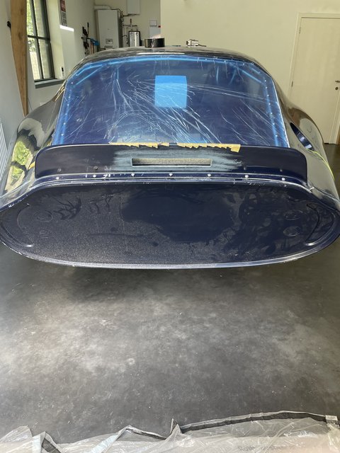

I recently had a rear screen made out of lexan for my coupe and it was 485 €
  #28 (permalink)

Thanks @Blacklemming, considerably cheaper than glass. Was it an automotive company that supplied it or a lexan company that shaped it? Also how is it fixed to the frame? Riveted?

It is a company that specialises in all kinds of plastics
Splashscreens,countertops,….
I have bolted it

Thanks for that. What did they use as a template? Bolting is probably better than riveting where you can control the pressure on the plexi.

I have a glas screen but prefer not to use it because it screams”kit car”
So they used that as a template.
And want the look to be as period correct as possible.
Bolting indeed is the better option
