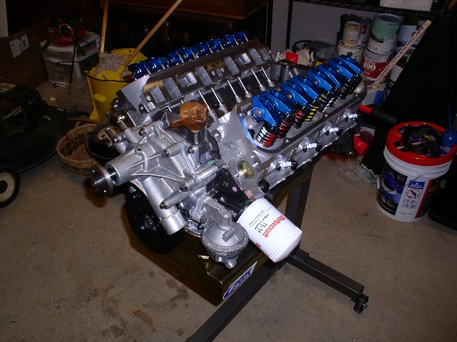

I have been following this thread. I assume you have the oil pressure sender installed into the threaded hole just aft of the fuel pump.(see photo). If you remove the sender and try to prime the engine the oil should squirt/ gush out of this hole. If it does, the oil pump is most likely doing it's job. After reinstalling the sender, I would try to prime the $hit out of it with a drill motor while having someone turn the crankshaft with a braker bar or wrench. It should eventually get oil up through the push rods to the rockers. If not, I would remove a rocker arm and then it's push rod to check if there are any obstructions. Upon looking at your photo gallery, I noticed something unusual. You stated you are using roller lifters. The following photo supports this. What has me confused is: the lifter guides seem to be missing in this photo. Did you subsequently install them?
Steve
All my ex's live in Texas

Yes, the guides and the retainer were installed. They are just not shown in the picture. Great pick up. (No pun intended)
I really appreciate all the extra effort to help with this. Family obligations have kept me away from the garage this weekend but I will have a little time off at Thanksgiving.

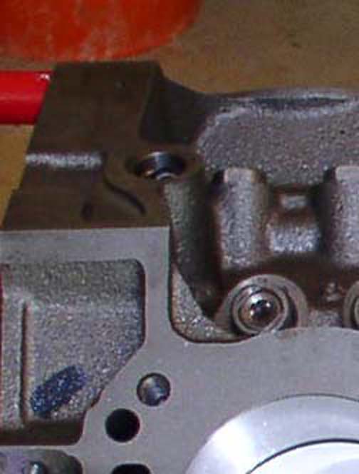

Fox, did you make sure the plug is installed at the back of the block? You can almost see it in the picture above....it should be back there where that little red thing is sticking up above the block.

Holy $hit! Batman, I think you figured it out. Looky-a-here: Whats missing from this picture??

John,
Damn!, me: "Du- maas", Blykins: "Jeenyusss". Hmmm, "no oil to the rockers upon priming" I think most of us would have just started her up and let her go to the dogs. Good catch!! let us know what you do.
