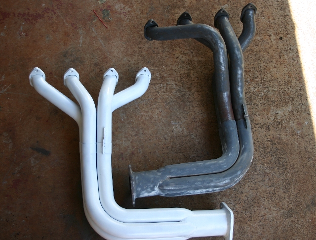

Default Weld on dude!
My friend likes my setup so well he's going to convert his sidepipes by welding a flange also. Makes it super easy to drop the side pipes at the race track. I have a set of "shortys" I bolt on when the sidepipes are off, looks really mean!

Default Flanges
I have changed the side pipes on my Blue E-M by welding a flange onto the headers. I made my flanges. My friend, Colin had a shop make him 4 flanges for his Shell Valley slip type headers. They made them out of 1/4" plate and charged him $7 each. We had to drill the 5/16" holes to bolt the flanges together but they cut the 2" holes. I welded the flanges onto his side pipes and headers. Job takes about 5 to 6 hours. A muffer shop can expand your pipes to 2".
