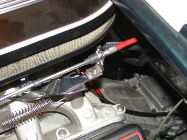

Why do you want to have a forward pull throttle cable? I like to drill a hole in the firewall behind the air cleaner so it isn't really seen. Maybe your kit doesn't have a similar set as mine. Maybe these will help.

No it is a uniflex throttle cable from CSR. You can find them at they're website www.csr-performance.com They have a lot of items I use for my builds.

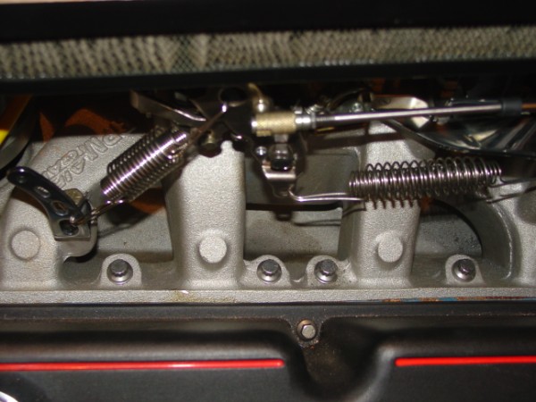

I routed mine to pull from the front of the carb. My engine mounts were modified to move the engine as far back as possible. As a result, the rear of the engine is at about the same lattitude (proper word?) as the pedal mount which results in some bind. Mounting forward is no big deal. Just reverse the throttle cable bracket and mount to the lower part of the carb arm that actuates the throttle plate (as opposed to the top of the arm for rearward pull). I had to cut a small piece of aluminum for use as a bracket to extend the throw to fully open the throttle. My setup employs a Holley aluminum bracket and a Lokar universal cable. I can take a pic if you like.

My pedal lever exits the upper front side of my footbox. Two options..... go with "original style" rods and heim joints or do a front pull system with a Lokar.
Looking at these options. Pics would be nice. I know I sdaw this setup somewhere on this site.

yes we had this question before, look at my gallery, if you click twice on my engine photo it will get real close, you will see my forward pull Lokar universal cable hookup, in the photo I still have the Edelbrock carb on, I have since changed to a Holley, still using the same cable hookup, there where some folks who said that the Lokar cable had broken on them, mine has not

I try to stay away from Lokar. I have had two failures, the ball came off the end of the cable. I also have several that haven't had any problems as well. I like the uniflex cables better.

On the Lokar cables I have only seen one failure and it was the stainless braided style. Also based on my discussions with other builders (high build numbers) the standard style with the black sheath hold up well. Two springs are sufficient with the Lokar style.

Based on your experience, I guess. The failures were due to a two spring set up not on a 4 spring setup as pictured.

Check my gallery - I added two pictures of the carb linkage
