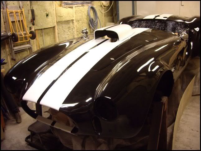

Large scoop? Here is my scoop, its LARGE
Little bit to large for my taste. But i have not so many choises just now.

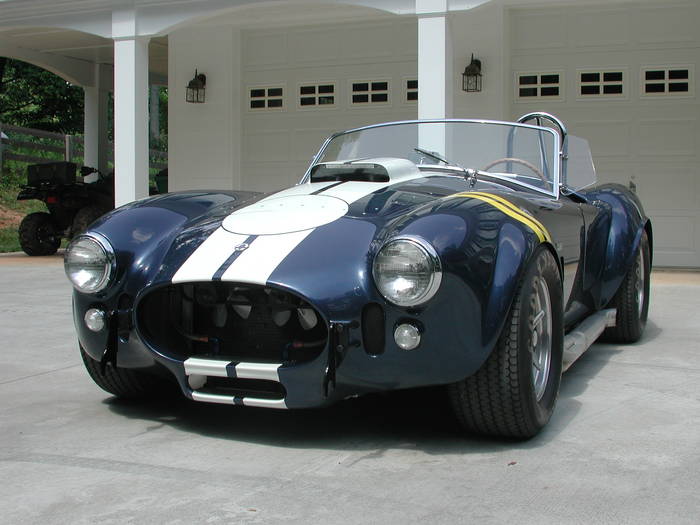

I've put a few photos of my larger scoop here: http://www.firstcoastcobraclub.com/v...c.php?f=8&t=70
It allows a 4" high filter element, necessary for the 521 to breathe properly.

I take it the lip coming up from the original hood line inside the front of the scoop is to keep rain out from under the hood and off the distributor?

Mike,
Keeping the rain out is the theory. Not sure if it works, but the first one had no lip and to my eye, this one looks better.
I've run each in 1" per hour downpours - on and off for up to 2-1/2 hours - (how smart is that?) and no problems with water on the distributor. I use an MSD and it seems to be water-resistant enough.
