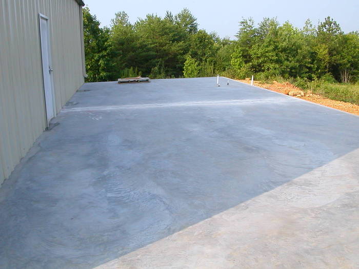

I had 1000 sq ft added to my shop and a 11' x 50' driveway, about 24 yds total. Cost $3600 for material and labor. Concrete cost $90 plus here. I asked three concrete finisher if they would use fiber or wire for their our slab and they all said,wire.
