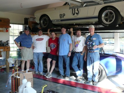

[quote=Karl Bebout;949015]Three of us managed to carry the individual pieces, except the ramp that had the hydraulic cylinder attached. For that, we used a four wheel wooden furniture dolly that had been collecting dust in the garage. QUOTE]
Same here, 5 guys & 1 gal, 1 case of beer and completed in 3.5 hours. Take your time and read the directions!
Steve S
F-250 w/ 6.4 Diesel
Old 05-14-2009, 06:30 AM
LuvDaBlues's Avatar
Location: Heath, TX
Posts: 756
Same here, 6 guys & 1 gal, 1 case of beer and completed in 3.5 hours. Take your time and read the directions!
By the way. Even though you're not required to anchor to the slab, I would recommend it. Some weekends I operate the lift many times while working on the cars. It's just a comfort level I like. 5/8" grade 8 bolts with expansion shields. Four per base plate.
