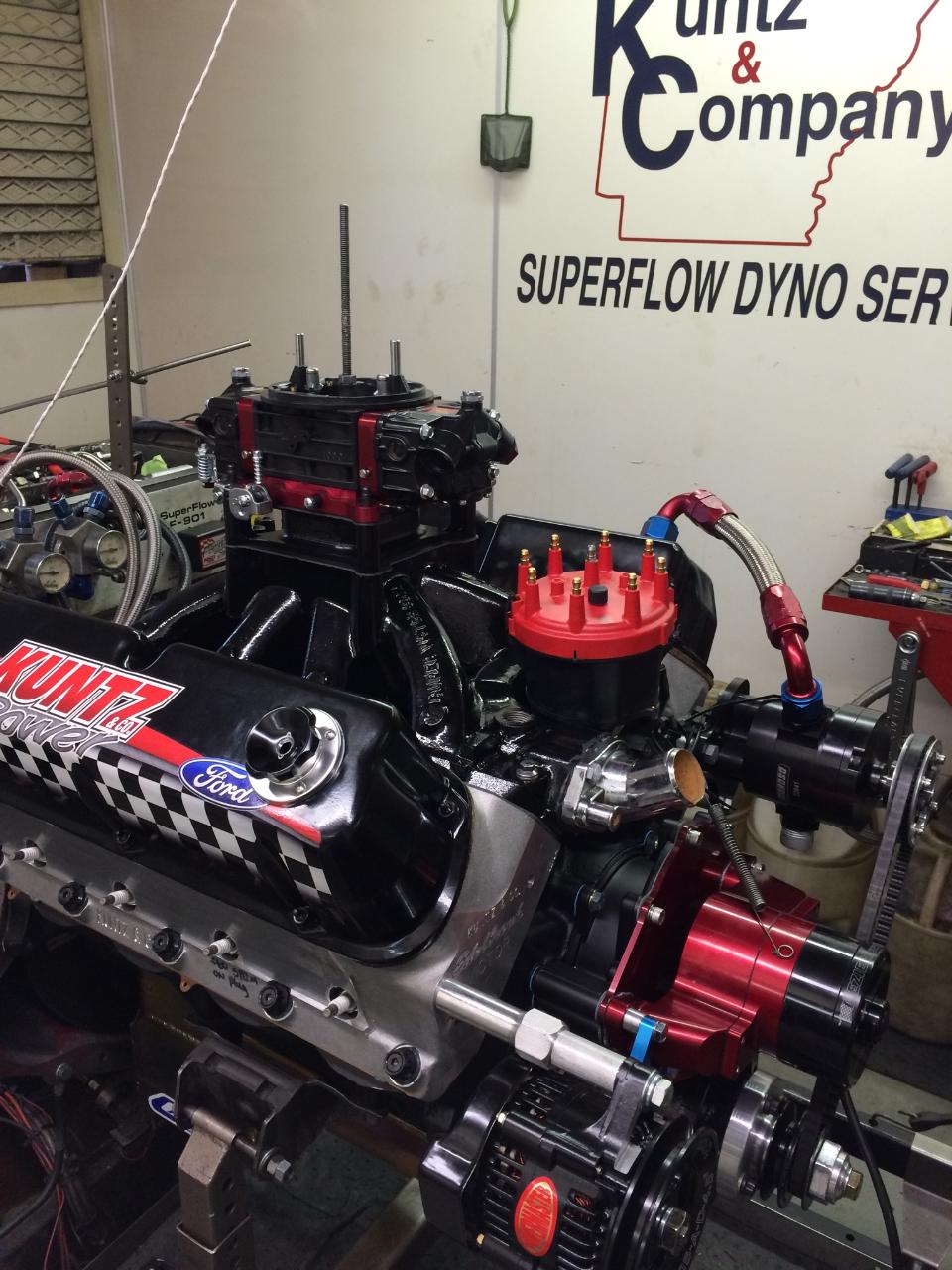

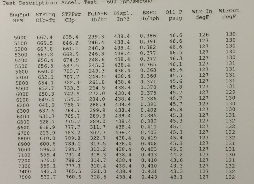

I would like to share the results of an engine recently built by Jim Kuntz (kuntz & Company). He sent me the results after we had had a long discussion on cylinder head runner volume, and port velocity. I will post the dyno sheet, but first take a guess on what it made??
This engine is a 438 SBF (4.100 x 4.125), 11.5 compression, and dynoed on 92 octane. All parts are off the self! This engine is being placed in a street car and will happily idle at 1100.
Induction Parts list includes Jims Victor Heads (Valves 2.15 1.6 stainless) T&D Rockers (1.7 ratio), Super Victor Stage Intake (gasket matched only), 850 QF, Solid Roller Cam 262 270 750 lift 108LS (ramps, medium aggressive) Crower Sever Duty lifters, and Moroso Vacuum Pump,
Short Block consist of Dart Block, Eagle Crank and Rods.

680 at 7200rpm.

650 hp @ 6K ???

I'll wager a guess and say whatever the dyno says it will be a bunch. Sounds like a good combination of parts and specs. 716hp with more compression and good gas.

691@6900

Here u go.
Old 03-24-2015, 05:34 AM
Join Date: Jul 2003
Location: West Bloomfield, MI
Posts: 717
Potent package there.
You have better "shelves" than I do.
At 1.52 TQ per cid on 11.5:1 compression that package is far from the normal expected range of "off the shelf" components. Although the RPM band on this build is considerably higher, the overall numbers would have been very, very competitive in any of the Engine Masters competitions - and I suspect that none of those would have been considered "off the shelf".

I recognize that engine...
PLDRIVE likes this.

Mark,
I can understand why you incorrectly jumped to the conclusion that my comments were about your engine. But that's not what I said. I stand by my opinion. .... BTW, the engine in that photo would not fit under the hood of my Cobra replica.
Tommy

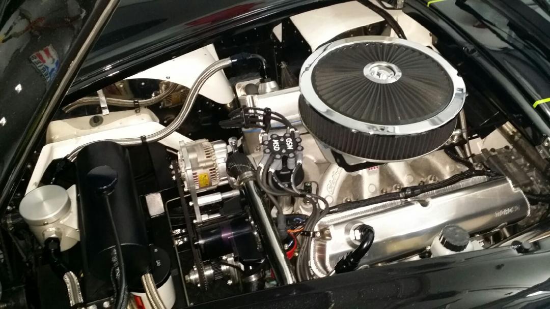

Originally Posted by Tommy View Post
Mark,
Tommy the pictures i posted are not my engines.
Care to elaborate on what u actually meant??? If u are saying this engine is not practical to be in a street car i totally agree with u, however; neither is the one i have in my cobra (picture), but i still drive it on the street, its legal, and its not far behind this one in power. "maybe i need a new set of Kuntz's Victor Heads"
The whole point of the post was to show what power can be made without using exotic parts. Not saying a new cobra owner needs one.
Mark

Old 03-21-2015, 07:21 PM
Tommy's Avatar
Location: Dadeville, AL
Posts: 2,459
The first picture.
Tommy
