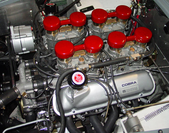

I just fabbed up a set like the ones you see below & SENT THEM OUT FOR POWDERCOAT. The decals can be purchased online through a couple different sources. YOu can find the early valve covers on ebay for around $15-$20. YOu will need to buy the materials to add the risers, braces & plug & breathers

On the picture, placed from „Tongue Pirate“, is an “expansion-tank” visible.
Has any one some idea, if and where this tank can be ordered?
Many thanks for your help
ALF

You can get them made up at ERA (I did) but they are not cheap!

Cobra Restorers sells one, not cheap either.
