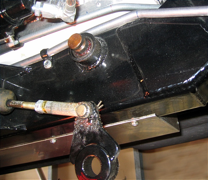

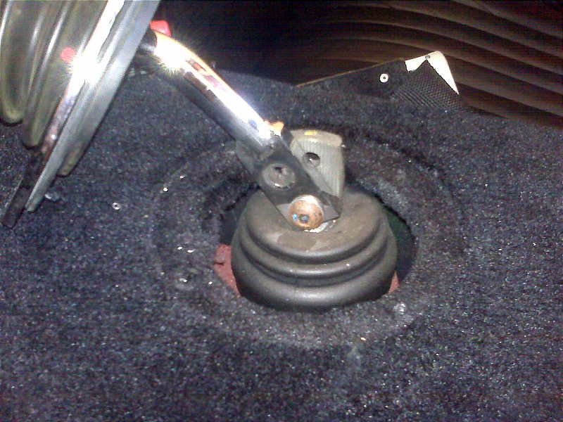

The safety wire that runs between the two Terry Body springs is just there to prevent one from some how rattling loose and falling off. That has never happened, but I tend to safety wire anything I can on that car as that FE shakes it pretty good. My last two "stranded out in BumFu**" threads have been the result of little insignificant bolts and screws that vibrated loose. In fact, as an onwer of a new-to-you ERA you should check the clutch throw-out arm set screw and the shiftter linkage bolts to make sure they are tight. A cursory examination will not ferret them out -- you have to go look for those two gems. While you're at it, tighten up your motor mounts as well.

Default Two Things Gunner Should Check Tonight on his ERA
Hey, tighten up your own damn... oh. Okay.
I've heard the bit about the clutch setscrew: what and where is it? EDIT: Got it, you posted the pix after I started this. Thanks.

You would never, ever find it unless someone told you to check it.... or you went for a big shift and the pedal goes all the way to the floor without doing anything.

My original thread has a better pic of the teeny, weeny, eensie, barely there, set screw. Ehhrggg, Standed by a Set-Screw

So I decide to pull off my (torn) shifter boot, replacement on order, and to my satisfaction, my shifter is held on by two beefy 5/16 bolts.
Um, one of which is a half inch out of its socket. Yipes. I think I need to line up the wrenches for a full workout this weekend...
