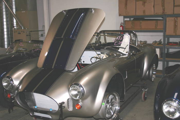

John - Here's a couple of pics of an SPF with a factory installed roll bar.
Doug
